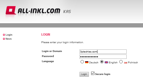

1. Login to your Kasserver account, selecting your most preferred language.

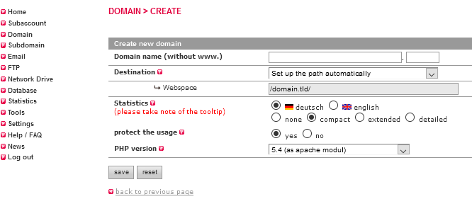

2. From the left side of the window, find the “domain” button from the navigation tabs and tap on it to show the other options. Locate the “Create new domain” button from the right side of the window and click on it. Fill all necessary details as seen below.
how to add a domain name to KAS all inkl kasserver
3. Click on the “save” button after entering your domain name in the boxes.

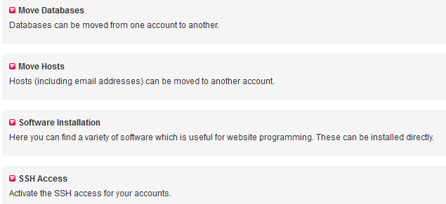

1. Click on “tools” from the left sidebar and find the “Software Installation” button.  How to Install WordPress on kasserver

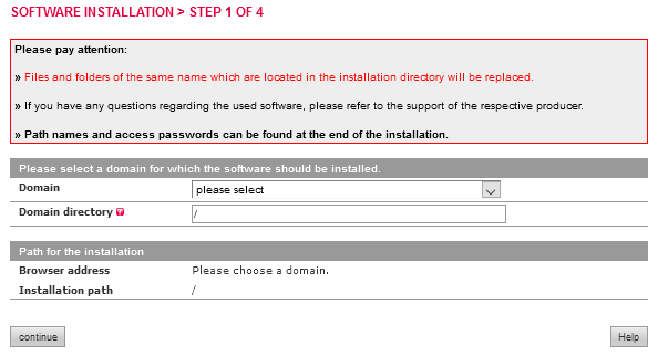

2. Configure the correct options by selecting your domain name and WordPress installation directory.

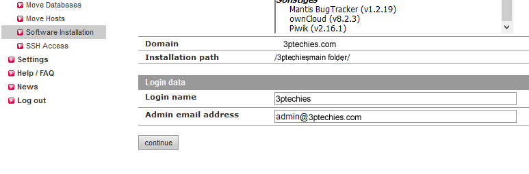

4. Enter the admin Username and email you will want to use in the boxes provided.

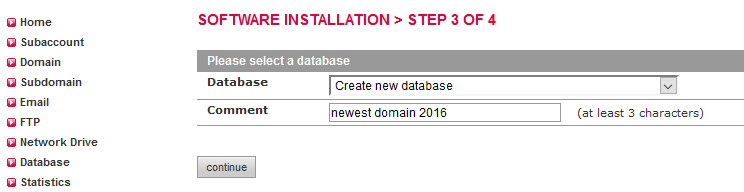

5. Select the option to “create a new database” and enter a name you can use to differentiate it from other WordPress installations on the server.

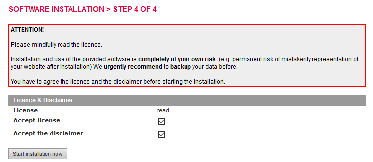

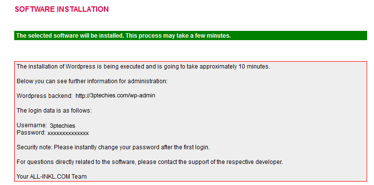

6. Accept their License and disclaimer terms and then, hit the “start installation now” button to complete the app installation.
Tips to add WordPress to kasserver
7. Use the details provided in the next window to login to your WordPress administration panel and start customizing your website.
