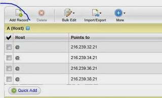

==> Create “A records” using the following  (google owned) I.P. addresses as seen below
  • 216.239.32.21
  • 216.239.34.21
  • 216.239.36.21
  • 216.239.38.21

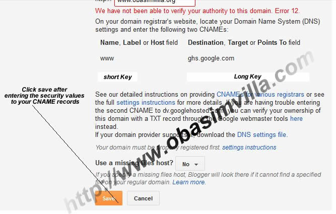

==> Save Zone settings and log in to blogger
==> Choose the blog you intend saving the custom domain name for
==> Click on settings –> Basic –> Blog address –> + Add a custom domain (Point your own registered domain to your blog.)
==> Enter your new domain name and save (at this point, google will tell you that you must claim your domain name first)
==> Now take note of the secret keys google generated for you after the warning message (That’s what we need for the final steps)
How to Build a Full Width Site: Tips to Remove Sidebar in Blogger
custom domain setup guide
==> Create another “CNAME records” using the values below
  • CNAME (Alias) = short security key
  • Pointing to = long security key
==> Save the zone settings and also save the custom domain from your blogger dashboard.
