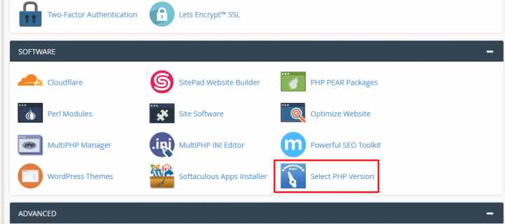

Cpanel Method: If your host uses Cpanel, you can increase PHP memory size and WordPress file upload size by using the select PHP version plugin.
To get access to this tool, log in to your Cpanel via yourwebsiteURL.com/cpanel ==> Scroll down to software and locate select PHP version as seen in the screenshot below.

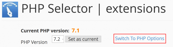

select php version
Click on it and then select Switch to PHP options.
switch to PHP options

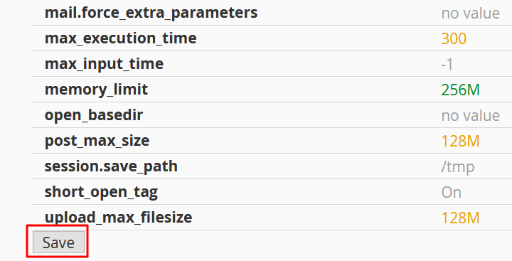

Increase the memory, execution time, and file upload sizes. Click on save changes as seen in the screenshot below.
change file upload values

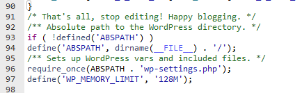

wp-config.php Method: If you prefer this method for increasing your WordPress upload size, simply locate the file named wp-config.php from your WordPress installation directory and add the line below at the end of it.  The line to add is: –
define('WP_MEMORY_LIMIT', '128M');
edit wp-config
Save changes and confirm there are no file size errors no more.

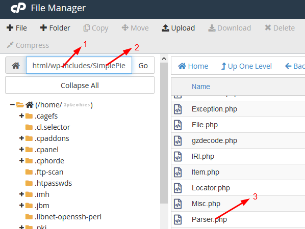

  1. Log in to your cPanel or use an external FTP client to access your WordPress installation directory (files). For managed WordPress hosting, the default file management tool or plugins like WP file manager can be used for this.
  2. Locate a folder name wp-includes and click on it.
  3. Find another folder named SimplePie and click on it.
  4. Locate a PHP file named Parser.php and right-click on it. Select edit from the options and click to edit the file.

  1. Save changes and go back to use the blogger importer plugin. Everything should work great at this point.

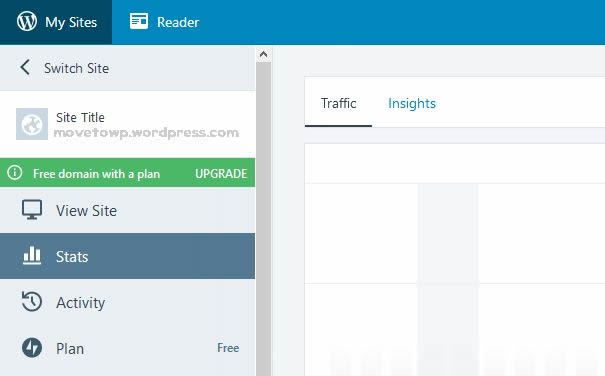

Well, you can migrate your blogger contents to WordPress by first migrating it to a Blogger friendly environment. For this tutorial, we are going to use wordpress.com as the bridging CMS. To use wordpress.com for an easy blogger to WordPress migration, complete the few steps below:
  1. Create a free account at wp.com and get a test URL.
  2. Export your blogger contents to a folder you can easily remember

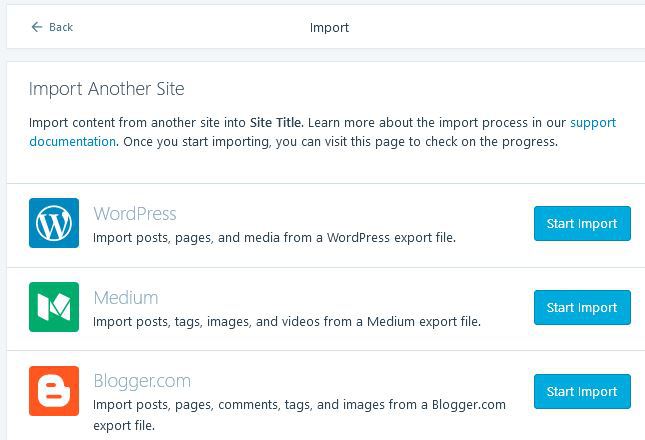

  3. Log in to your WP-admin dashboard and find a button named Import (from the left menu items).
  4. Click on it and select blogger.com from the options displayed.
select blogger from the options
  1. Click on Start Import
  2. Upload the blogger contents file you’ve backed up in step2 above.
  3. Wait for the import to complete.
  4. Assign authors and go back to your WP-admin dashboard by typing myfreewpaddress.wordpress.com/wp-admin in the address bar.
  5. Click on Tools ==> Export and save to a folder you can easily remember.
  6. Import the exported content to your main WordPress.org URL. You are all set and done without using the blogger importer plugin.

    For the increase memory limit i’ll also want to share a bonus method.
    You can actually increase you WP memory limit by editing or creating a new php.ini file on your cPanal root folder.
    Search out to see if there’s an existing php.ini file and modify it by adding the following code below.
    If there is no existing php.ini file, you can create one and enter the code below.
    1. upload_max_filesize = 64M
    2. post_max_size = 64M
    3. max_execution_time = 300
    The above code will set your limit to 64MB, you can choose any custom size but make sure it does not exceed the allocated size from your host.
