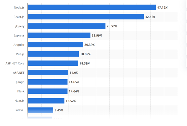

This is why ReactJS is the second most preferable web framework worldwide, with 42.62% usage.
