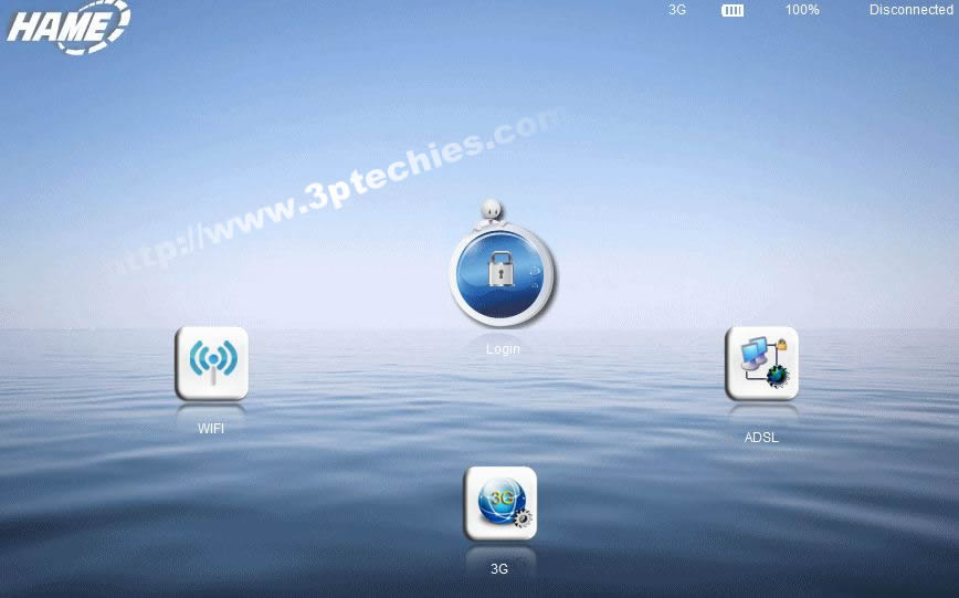

How to Change from Chinese to English Language
Maybe Hame didn’t expect their product to go as for as Africa, Europe and America without remembering there’s eBay, aliexpress and Dhgate.
Any way, that’s left for them to worry about. Now to Configure your Hame 3G Wireless Router to use English instead of Chinese when using the admin dashboard. Kindly follow the steps below;
  1. Turn on the Router by pressing the power-on button by the side
  2. Open your favorite web browser and enter  http://192.168.169.1/goform/setSysLang?en
  3. Use hame or admin as the password depending on your device (mine was hame)
  4. If requesting for both username & password, combine both either ways (hame/hame or admin/admin)

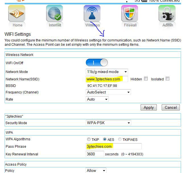

Now to change Your admin and Wi-Fi Password
Continue from the dashboard by hovering over “admin” select “management” and change the settings under “Administrator Settings” to your own preferred variable. (default is hame/hame or admin/admin)
Changing Default Wi-Fi Password
This is very much like that of the admin details ==> Just hover over “Wireless” from the main menu and select “WIFI Settings” ==> Change Network Name (SSID) and Pass Phrase from there. Remember to select a security mode or leave it at the default option.

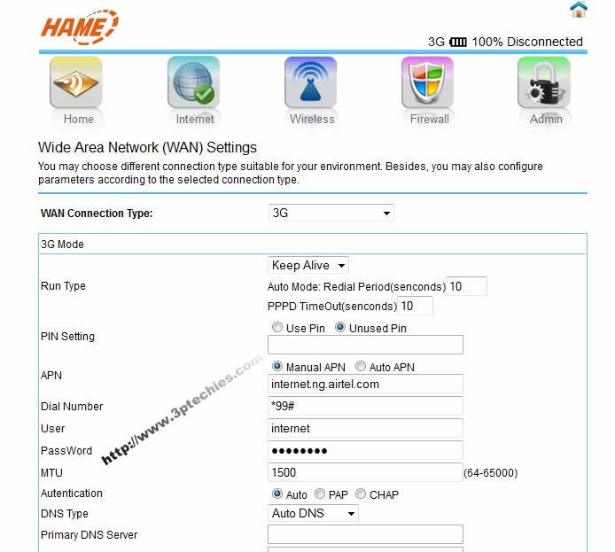

Creating a Manual APN Settings to Match your Mobile Internet Service Provider
Everything about Hame 3G Wi-Fi Router is automated from setup to connecting to the internet, but most mobile telecoms operators do not support automatic profiles and as such will need a manual APN configuration.
  • Hover over “internet” from the main menu and select “WAN Network”
  • Choose 3G as type and Check the Manual APN box
  • Enter your Access Point Network details as required and hit “apply” button to save

APN Settings for all Network Providers in Nigeria
If you are using this modem in Nigeria or using any of the Nigeria telecom service providers, here are the various APN settings that should work for you.
Glo Nigeria
APN = gloflat
Dial Up Number = *99#
Username   = flat
Password = flat
MTN Nigeria
APN = web.gprs.mtnnigeria.net
Username = web
Password = web
9Mobile Nigeria
APN = etisalat
Username   = blank
Password = blank
Airtel Nigeria
APN = internet.ng.airtel.com
Username = internet
Password = internet
If you are outside Nigeria, Ghana, Kenya, South Africa, Germany, France, Mexico and Jamaica, you can visit here for a more comprehensive list of APN settings or get them from your network providers over the phone or from their various websites.

    3. open browser, type “192.168.169.1” and press enter
    4. login using username and pas : “hame” (lowercase)
    5. click Internet -> WAN Network -> WAN Connection Type and choose SMART
    6. Enjoy your connection
    Setting Wifi username and password :
    1. (after step above)
    2. Open Wireless -> Wifi setting -> Change Network ID (SSID) whatever you want -> Security Mode, choose WPA2-PSK and in pass phrase column, fill your password whatever you want -> Click Apply
    3. Reconnect your devices to wifi
    4. Enjoy your securable wifi

  32. hi. my hame R1 doesnt dial 3g automatically, and i did setting APN manually, but doesnt start to connect internet, what i must to do ?
    • What happens when you log on to the settings window via your PC’s browser?

  37. I am unable to connect Hame MPR-A1 with Tata photon 3G. can you pls help?
    • HI Kishor,
      Can I get an idea of what problem or the error message you do normally get when trying to connect?
      • I do not get any message. The status shows as “Internet not connected”.
        Am able to connect to WIFI from my PC. But, internet is not available since the router is unable to connect to the Photon 3G. It is a HSUPA MF190 USB Stick from Tata Photon.
        • I am not sure of the problem you’re currently having buddy. But as a test, can you try installing connectify (connectify.me) software on your computer with the USB modem connected to the PC instead and check if that allows your phone to browse the internet.
          This will allow me give other advice from here, else you may need set correct APN values from your network provider.

  45. Hi,
    I have disabled the wifi button off in wireless section to connect back how to open the setup page. im unable to find the fix please advice
    • Opening the setup page is quite easy…….. Type http://192.168.169.1 in your address bar and log in to access the setup options…… let me know if there are other issues ASAP

              • Hi, I did reset no of times then it got reset and get proper working now. from few days the device is getting reset by itself. I dont know what is the reason.
              • Hi did u managed to get ur wifi issue resolved & if yes how
              • Hi Vikas, I did reset with papaer pin hold for 10 seconds untill the red indicator start blink remove the pin and see the blue blink indication continuously then connect with ip and do settings of your data card.
                Mine is Reliance data card #777, user namme and Pwd data card number and works great.
                In WiFi settings WPA section TKIP/AES for non-android or other devices to connect
                Now it rocks.. no issues till now
            • since you diabled wifi you cannot login wirelessly. plug in your LAN cable to both PC and router and enter address mentioned above. then login to the dashborad page as usual and turn wifi back on .
        • You’ll need to connect your router to the computer before visiting that address to complete the setup friend
