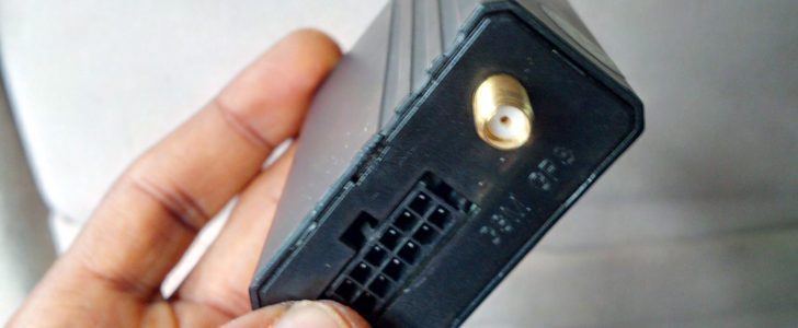

Install Sim card and Battery: This part is quite easy to complete. All you need do here is
  • Open the frond cover and pull out the PCBA board.
  • Insert the SIM card to the SIM slot (all GSM network SIMs is supported).
  • Plug the battery to the socket.
  • Put the PCBA board and frond cover back.
N/B: It is advised that you leave the button to power off mode while installing and unloading the SIM card.

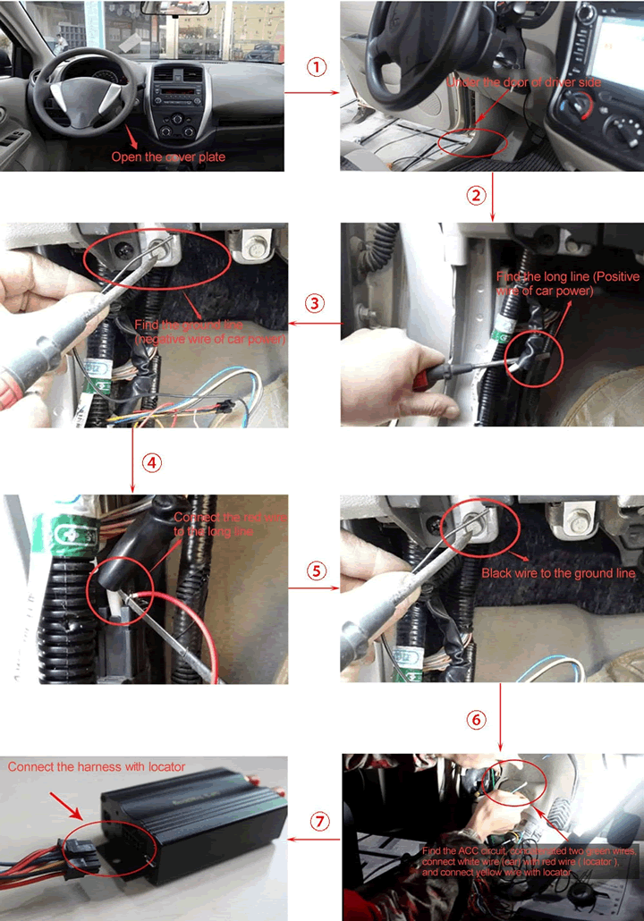

Step 3: Open the vehicle’s cover plate as shown below, and follow after the detailed circuit instructions.
nto gps car tracker review and installation guide
Step 4: Turn on the device, and monitor the led indicator to make sure that everything is working as described in the user’s manual.
Step 5: Screw back the loosened points appropriately and install the mobile app on your preferred device.

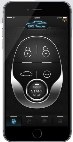

Tracking via the Smart Phone App
This is possible for Android, iOS and Blackberry 10 users. Simply search for “NTOGPS” in the app store to install or manually download the raw installation file (.apk) from their tracking platform.

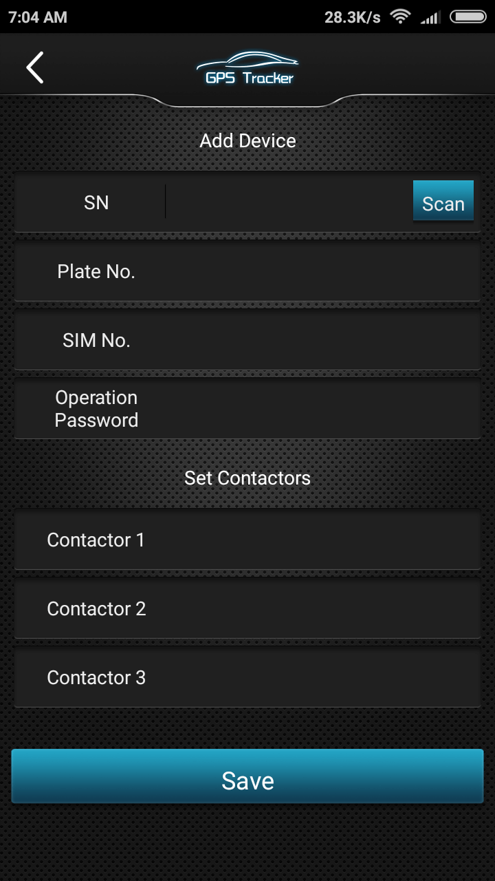

  • Launch the app after installation.
  • Enter email address/password to login.
  • Click on the car’s icon to add a vehicle and numbers to contact for; when it gets stolen or falls to a wrong hand, emergency and alerts.
  • Save and play around the other buttons to familiarize yourself with the app’s functions.

        Have you been able to log in to the app? that’s the first step. You can add the GPS tracker under devices by scanning the bar code as seen in the screenshot below NTO GPS tracker review and tutorials. You can sign up or request for a forgotten password via this link.
        N/B: If seller code is the challenge you’re having, you can use the default or contact them directly to solve this challenge.
