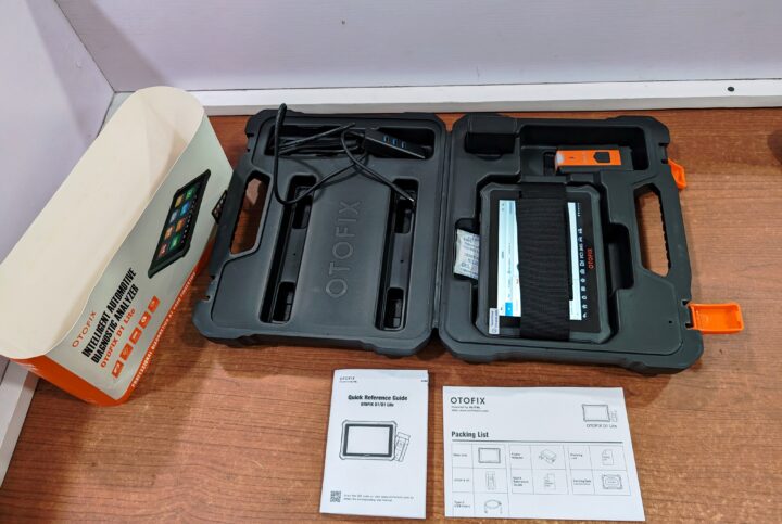

What’s In The Box?
Otofix D1 Unboxing

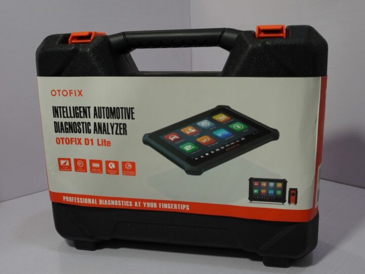

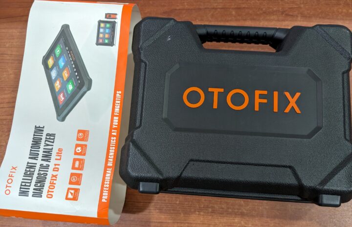

Although we got a small Loacker Minis Napolitaner biscuit placed on the outer box packing of ours, what you’ll normally get with a new purchase of the OTOFIX D1 Lite Auto Diagnostic Scanner are the items listed below:
  1. The main unit (OTOFIX D1 Lite Tablet)
  2. OTOFIX V1 (The Vehicle Communication Interface)
  3. A USB Type-C cable (can be used to connect the V1 to the Otofix tablet instead of Bluetooth)
  4. A UK 3-pin power adapter
  5. USB-to-Ethernet adapter (with 3 USB ports)
  6. The user guide
  7. The Packing list
  8. A carrying case

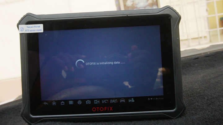

Thanks to the cloud connection support, you can view diagnostics test results from your mobile device. OTOFIX D1 Lite has a 7-inch LED display screen that supports 1080p HD resolution for a crystal clear display of results. The battery capacity is massive; a whopping 5800 mAh 3.85V lithium polymer battery. It also packs a 64GB ROM paired with a 2GB RAM chip. Hereunder are the full specifications for your reference:

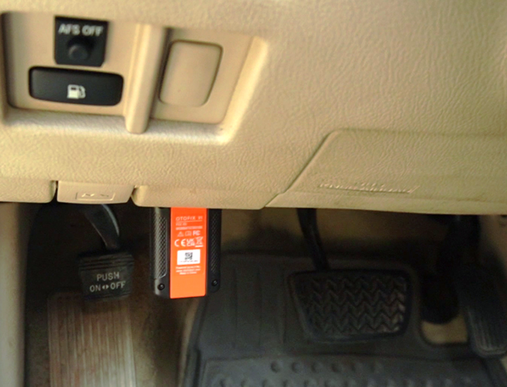

Step One: Connect the V1 Device
When you purchase the OTOFIX D1 Lite, inside the box is an OTOFIX V1 device, which is the unit you will connect to your car’s OBD II port. Connect the V1 to your car’s OBDII port and then power on the OTOFIX D1 Lite Tablet.

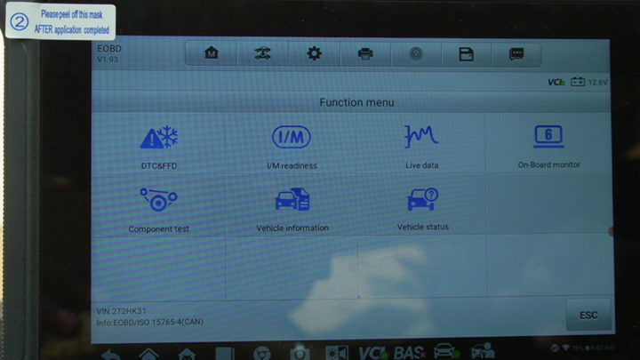

Step Three: Run Your Choice Diagnostics
To confirm that your D1 Lite tablet is connected to the V1 device, the VCI icon on the bottom bar will show a green BT icon. Once you see this, you can proceed to run any test you want to try out. Now, this is where it gets personal; the scan you want to run may differ from what another car owner would want to run.
Nevertheless, all available services are clearly shown on the “Services” page. Here’s a general step to run a diagnostics using this tool:
  • Click on the “Services” icon on the bottom bar (it is the last button on the row with a mechanic icon).
  • Select the service you want to perform: read live data, oil reset, engine check, transmission test, or anyone at all.
  • Identify your vehicle brand, OEM, and model (although the device will try to automatically pull your car’s information).
  • Run the diagnostics. You can perform a full system diagnostics scan if you want to check the status of every system in your vehicle.

Otofix D1 Pro system scan The system scan worked seamlessly – scanning, detecting, and showing the detected error codes without any manual input from my end. But a majority of the functions in the “services” menu will require one to select the Vehicle make, model, ECU type, etc. before getting the required result. This can be very inconvenient to an average car user who isn’t familiar with these technical terms.
