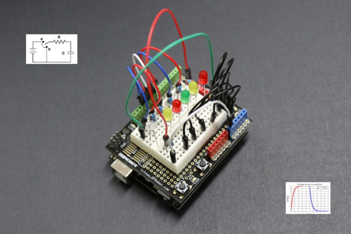

Let’s start from the very beginning, with what those initials mean: R and C refer to a resistor and a capacitor, respectively. These components are combined in an RC circuit, and the RC time constant tells you how quickly the capacitor charges or discharges through the resistor.
After all, when voltage is applied in an RC circuit – such as from a battery – the capacitor doesn’t charge instantly. Instead, it takes time because of the resistor limiting the current flow.
The RC time constant, then – denoted by the Greek letter tau (τ) – is the time it takes for the voltage of a charging or discharging capacitor in an RC circuit to change by approximately 63.2% of its final value.
Charging vs Discharging: What It Means for The RC Time Constant
The distinction between these two processes can sometimes be a source of confusion. So, let’s set it out quickly before we launch into the specific calculation for the time constant:
  • Charging: A capacitor charged through a resistor will reach about 63.2% of its final voltage after one time constant. It is regarded as practically fully charged (over 99%) after approximately five time constants.
  • Discharging: A capacitor that is discharging through a resistor will drop to approximately 36.8% of its initial voltage after one time constant. It is considered practically fully discharged after around five time constants.
