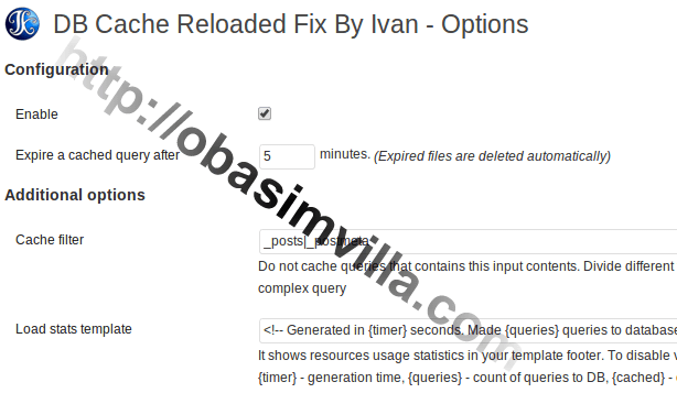

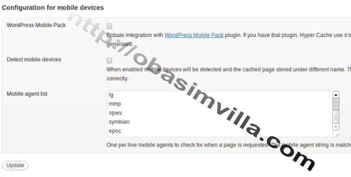

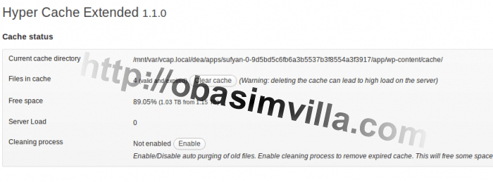

Hyper Cache Extended combined with DB Cache Reloaded Fix
Best wordpress caching plugin for shared server
Believe me when I say that this very combination is one sure messiah and live saver for every wordpress blog or website hosted on low cost shared servers, this is because the speed is optimum as opposed to what you will end up getting if you decide to go with the big guns out there while using a low cost shared server.

If you are very desperate for “speed of light” load time and less-server resources consumption for your blog and websites, you will either go for a dedicated server hosting plan and cruise alongside with you “the W3 Total Cache plugin” or stick with my advice of combining “hyper cache extended plugin” and “db reloaded fix plugin”
Bonus Read : The biggest player in this very combination is the Hyper Cache Extended plugin meaning that using it all alone wouldn’t hurt your site at all but improves it to a maximally optimum and noticeable performance rate. You should also remove the “db cache reloaded fix plugin” if you notice any bug, internal server error or stick with the father alone, ‘cos it’s all okay by itself if not that they they both carry out distinctive functions.

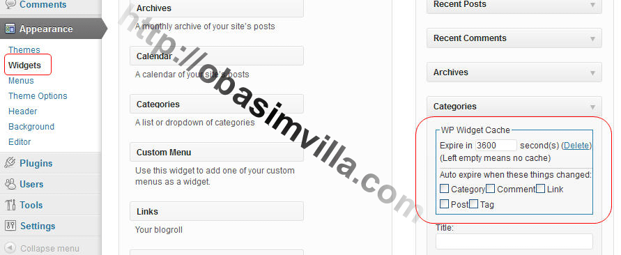

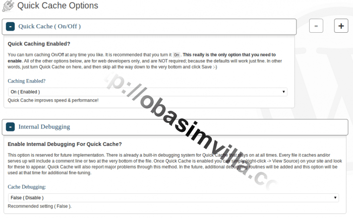

Quick Cache combined with WP Widget Cache
2 Best wordpress caching plugin for shared server
This will rescue the asses of most shared hosting users out there who has been wiped by their host for high server resources consumption  as it will not cache your dynamic files but will also cache the various active widgets in your blog thereby delivering a kinda static pages to thousands of visitors per-minute.
One good thing about this two plugins is that it requires no advanced configuration just like the two already listed above, all you need do is tap the off and on buttons, setting up the time-frame for your various caching on the go.

Many opinions already alleges that the “quick cache plugins” contribution to speed and performance is minimal when compared with the big players out there, that could be true only when you have not added the child “wp widget cache plugin” to the van.
Bonus Read: No bug, error messages and the likes has ever been heard of while using this two plugins together, but as a matter of respect, other person’s view and our personal discretion it is required of you to make your choice between this two combinations only when you must have tested the different options with the perfect page testing tool accessible from pingdom.com

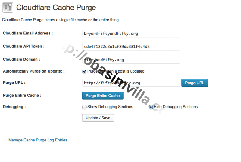

CloudFlare combined with Better WordPress Minify
If optimum performance is your goal, security and speed of light load time a concern to you, locating this two plugins would have been the first thing you should have done from the very start.
Premium solutions like Max CDN and the CDN solution provided by Amazon works great but wouldn’t be a concern to you on a shared server ‘cos they usually cost lots of money which you may not have at the moment.
my 2 Best wordpress caching plugin for shared server
We assumed that the money would have been spent for a better server assuming you already have it, this is why we are recommending cloudflare for many of you that are ready to do something better for their blog by improving the load time.
Bonus Read:  Many of us aren’t currently using cloudflare ‘cos they will require you to change your DNS to theirs before it will function for your site, this is something that most of us don’t actually love doing, hence opting out of their service.
You may also wanna disable the cloudflare plugin if you notice frequent irregular display of your site or unusual breakage of your theme’s CSS, this is because most themes and plugin aren’t fully compatible with cloudflare’s own caching system.
