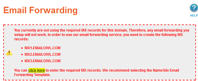

  • Log in to your NameSilo admin dashboard and find/click domain manager from the right navigation buttons
  • Locate the domain name you want to create the email account for and click on it
  • Locate Email Forwarding from the left panel and click on Configure
  • Create the email account of choice (eg. info) and add the Forwards to address (Usually your primary gmail account or [email protected]). If a warning message as seen in the image below appears, use the click here button to select and apply the Email Forwarding template.
namesilo custom domain email setup guide
  • Click on Submit and continue to the next step.

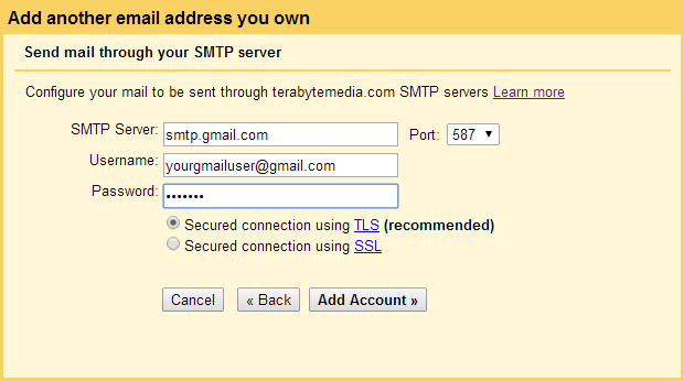

  • Locate Send mail as: and click on Add another email address you own
  • From the pop-up windows, Enter name and email address (usually the address with your custom domain name eg. [email protected])
  • Deselect “Treat as an alias” and click on next
  • Remove the values in there and enter Google’s SMTP server values as seen in the image below (smtp server = smtp.gmail.com, username= your_gmail_address, password= your_app_password_created_in_step_2_above)
namesilo custom domain email setup guide continues

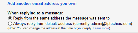

  • Finalize setup and go back to the send mail as: window and check the Reply from the same address the message was sent to box.

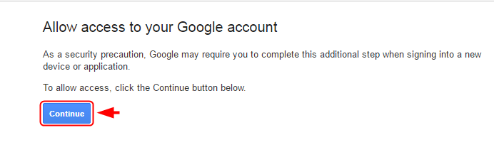

Note: Those not willing to enable 2 factor authentication on their gmail account can simply authorize Gmail SMTP server for Namesilo by completing these steps.
  • Click here, to log into your Gmail account, and then click on Continue.
gmail SMTP email config for Namesilo
  • Click here again to grant access for unsecured app and then continue from step 3 above. Note that step 2 was skipped for this method.

    I did that then Ii said this:
    Authentication failed. Please check your username/password and Less Secure Apps access for access*****@gmail.com.
    Server returned error: “535-5.7.8 Username and Password not accepted. Learn more at 535 5.7.8 https://support.google.com/mail/?p=BadCredentials f26sm1338525oop.46 – gsmtp , code: 535″
    • I get the same error as Maria. Please help!
  4. Hi,
    I tried your instructions however as I chose not to enable two factor authentication, I followed your instructions and then as you directed went to step 3, however in step 3 it requires the password in step 2 that I did not get as I followed the alternative instructions. What do I put in the password field? It will not let me proceed without a password, therefor not allowing me to do the final step “Finalize setup and go back to the send mail as: window and check the Reply from the same address the message was sent to box.” Help!
    • Hi Maria,
      That’d be your regular Gmail password for the account you’re going to use.

  6. One more question abut this line from your direction:
    In the Send Mail As, there is only a Reply to Address. I do not see Reply From. Can you do a screen capture of what this step should look like, for us all visual people.
    Thanks for your work!
    • Here’s a screenshot for that Nwaego email setup tutorial

  8. It didn’t work, because I got this message before I finished: Congratulations, we’ve successfully located your other server and verified your credentials. Just one more step!
    An email with a confirmation code was sent to (namesilo domain email, which I haven’t got access to yet.).
    There was an error in the MX setup process also:
    “There were problem(s) with your request:
    record does not contain all required values type/host/value/distance
    Please make applicable changes and try again.”
    It required hostname and target hostname. I didn’t know what to put in.
    If I had set up the MX records correctly, how could I then access the namesilo domain emails to verify the Gmail set up?
    • 3ptechies Default 3ptechies Default
      You have to setup a Namesilo email forwarding to a Gmail account first, so, the verification email would get in to your active email inbox
      • How am i suppose to get a confirmation email to the address i need verified if the email address isn’t verified? Forwarding wont work because it isn’t verified on gmails end so i can’t get the confirmation email. I followed all the steps. Doesn’t seem possible unless the email address already exist elsewhere.
        • i think i might know the problem. not sure if you can help. I am forwarding my namesilo domain to godaddy hosting (godaddy nameservers). im getting a warning stating that the nameservers are not namesilo defaults so any changes wont have any effect. If i temporarily change them to the defaults could i get the confirmation email? and then switch it back to godaddy nameservers and it’ll work? Thanks!
          • Godaddy hosting does come with a full-fledged email hosting option, you can make due with that instead of using this method Rob
            • thats true but they charge extra per email address. and it doesn’t make sense to pay for something that isn’t as reliable as gmail which is free.
              • You can create new MX record to use zoho free mail services

  10. I got lost after getting the 16 digit number I couldnt find where to put it
    • That would be under the SMTP server settings covered in the step 3 section of this tutorial Suz. The password bar, below username box.
