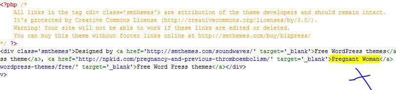

  4. You may have difficulties removing the footer links ‘cos they encrypt most of the footer links with base64 encoding tools and the likes

Evaluation : below is the screenshot of the initial red flag we observed while trying to use this themes after testing them with the Superior tools we are going to discuss below
