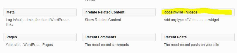

Take a look at the snapshot below for more details;
how to add videos widget to genesis child themes
how to add theme junkie videos widget to genesis child themes
The first snapshot outputs what’s gonna look like from your widgets list while the second options gives you the full options of the video widget in action.

The videos widget should now appear in your widgets list after hitting the save button.
