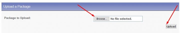

  2. Install the Mod to your forum website: To do this, log in as an admin to your forum, ==> click on Admin ==> Package Manager ==> Download Packages ==> Upload a Package ==> Browse ==> select the package you’ve downloaded in step 1 above, and then click on the upload button.

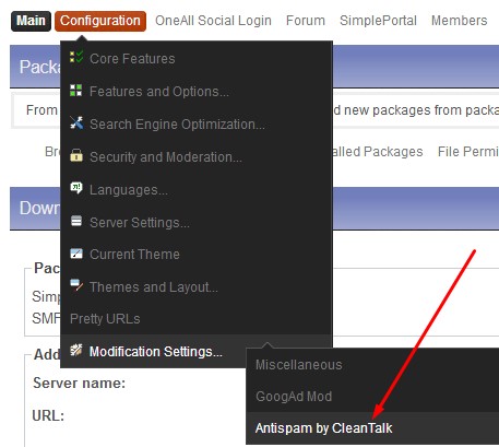

  1. Activate Mod: Once you’ve completed the preceding step, click on the Install mod button, and allow it to redirect you to the module’s settings page. If it doesn’t do this automatically, you can get access to this page by navigating to; Admin ==> features and options ==> configuration ==> modification settings ==> Antispam by  CleanTalk.

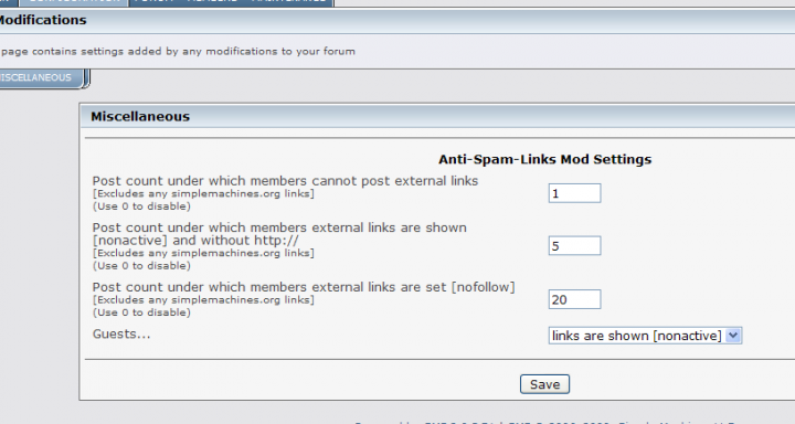

Once the installation is completed, ==> go to the settings page and add the resistive settings (based on postcounts) to help curb link spammers and shameless promoters.
Anti-Spam Links for SMF Features

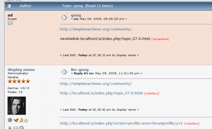

  • Can prevent new users from posting a link(s) on their first post.
  • Can set links to [nonactive] or [nofollow] based on user’s post counts.
  • Helps you control what users get a link that passes link juice (pagerank).
  • Has guest control option.
  • It is free and comes with no obligation.
