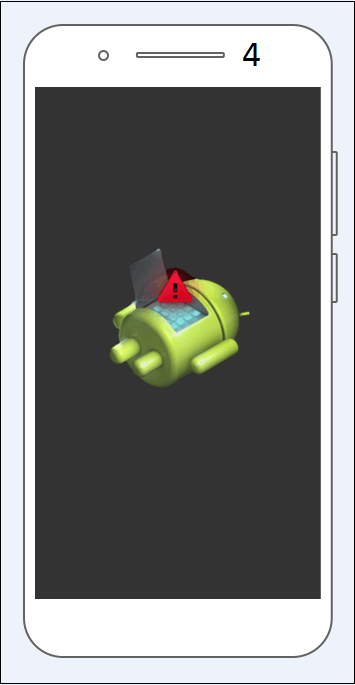

    Next, you would see An Android Logo, you can then release the volume up button.
  5. Now Hold the Power up Button for 2 Secs and then press the volume up button without releasing the power button.

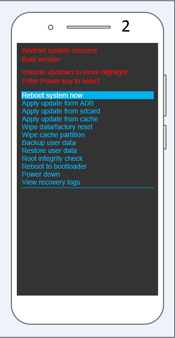

  6. You can then use the Volume down button to navigate through to Apply Update from SD Card
  7. You will be directed to a new panel. (image below)

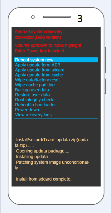

  8. Use the Volume Down to navigate to Tcard_update_20160415 then select it with the Power Button
  9. The Installation would begin now after which you should select Reboot System Now. (image below)

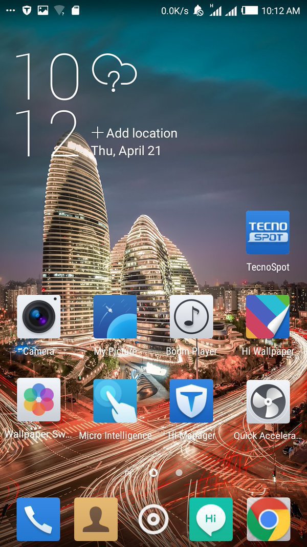

    After the boot is done, you should have HiOS and Marshmallow 6.0 on your C8.
  11. After this, your  phone interface should look like the image (final) below.

After doing all this, your New Interface should now look like the one below;
