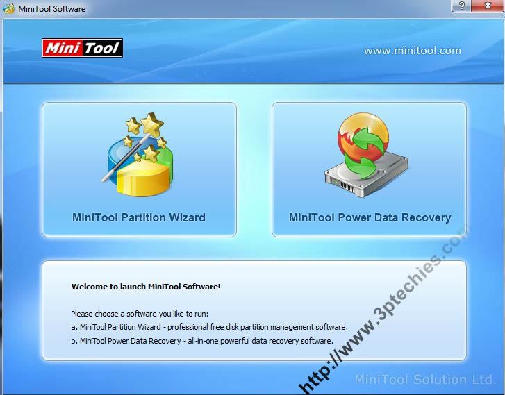

  1. With your memory card already connected ==> Launch the MiniTool Partition Wizard Software from your start menu or desktop
  2. Select  MiniTool Partition Wizard from the first welcome screen

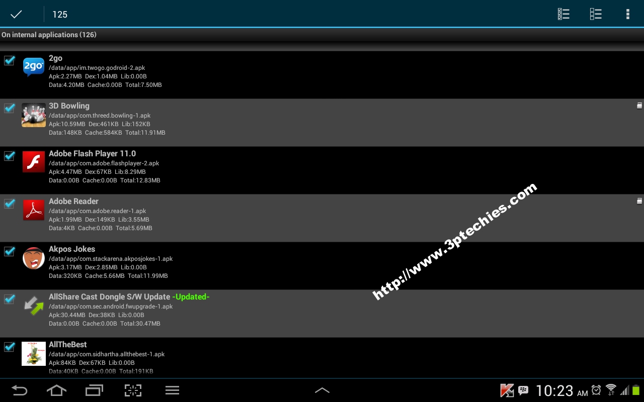

  4. From the application top right menu ==> tap the tube-like icon (as seen in the pix above) and ==> select internal
  5. Select all listed application using the multi-select option (as seen in the pix below)tip for Increasing the Internal Memory of Android Phones and Devices
  6. Tap on the “vertically aligned triple dot” icon on the top right menu to unveil the option key and ==> select create link
  7. Leave all the selected actions (ie; link application file, link library files, etc.) and ==> click OK when done.

            I am seeing one more issue now. As stated, I had linked all my apps to the SD card setup with a 13GB primary partition. And in Link2SD app, I had set the option to Auto Link new apps and also set the default install location to External in Link2SD app. Now, when I try to install a new app from Play Store, it gives me an error “Insufficient storage”. Can you pl advise what went wrong?
            • Did you move previous installation to the SD card? seems like your internal memory (apps) was already filled up to the brim. You can also plug back your sd card to the PC and run diskmgmt.msc to confirm that the partitioning was done correctly.
              You can also use the app referenced in the updated section of this tutorial.
            • Not_Too_Confused Not_Too_Confused
              You have to leave the default installation to ‘Auto’, and not set it to the SD card.

  22. LOL.. dude this doesn’t work.. atleast not on samsung galaxy trend plus with android 4.2.2 .. the only thing what happens is half the memory capacity of my external memory card is lost,as i formatted and splitted it as told in this guide. and the phone memory remains the same.
    • Thanks for dropping by Darra, just a few questions for you, did confirm the secondary partition was properly created by entering diskmgmt.msc in the command window?
      Secondly, following this guide isn’t going to physically increase your internal memory but allows you to use a portion of your SD card as internal storage.
      This allows you to free up your internal memory by moving and installing apps directly to it.
      Also point me to the message you normally get when trying to move with the link2sd app.
  23. “/data/sdext2 mount not found ” says when it is multi selected and clicked on create link ……..
    • Have you resolved this already?
  24. hey… i already do partion ext2 and i install link2SD but it dosent work!! help please… it’s showing ( mount script cannot be created. not allowed to su) do i have to install any other program?
    • Is your device rooted?
