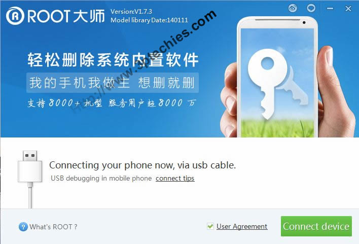

Just like rooting with any other software, Vroot requires that the following conditions are met.
  1. Must have a working Windows PC
  2. Must have a working USB cable
  3. Must have the proper USB drivers of your phone or device installed on the PC (You can download Android ADB drivers from here)
  4. Must charge your phone battery to at least 50%
Part B
How to root any android phone with Vroot
  1. Do a proper backup (should anything go wrong during the exercise).
  2. Download and install the VRoot software (Non-Chinese users must Download the English Version). You can also opt for the older version that was used for this rooting guide, I uploaded it to box app for future purposes. You can download it from here, and use if the latest version (linked above) fails to work well for your device.
  3. Enable USB debugging by going to ==> Settings ==>Developer options (also check the “stay awake” option)
  4.  Launch the VRoot software from your start menu or desktop
  5. Connect your phone or device to the computer using the USB cable that came with it. (Drivers must be properly installed for your phone to be detected)
  6. Allow VRoot to detect and display the model of your phone  (accept any USB debugging prompt)
  7. Tap the green “Root” button to root your phone or device
  8. The device will be rebooted and confirmed rooted by the Vroot software.
Sales Desk Review: A Reliable CRM Software For Businesses?
How to root all android phones with Vroot
You can see how easy it is to root various android phone and devices almost at a single click of the mouse button.
You can also unroot the device by repeating the process again and tapping the “unroot” button instead.

When vRoot Fails?
No universal android root software is completely flawless. As newer android versions are introduced, older rooting exploits would get patched and rooting them would normally take some time, as new rooting exploits needs to be created for them.
If the vRoot software fails to root your android phone or devices, you need not panic as there are even better and free alternatives for rooting lots of android phones, tablets and PDA(s).
