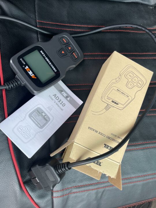

ANCEL AD310 Unboxing (What’s In The Bag)
We got our package via DHL, hence, an extra box of packaging came with it. Hereunder are the items you’ll get in a new Ancel AD310 OBD2 scanner purchase.
Ancel AD310 OBD2 Scanner Unboxing
  1. The OBD2 Scanner Tool
  2. A detailed user manual
  3. A cellophane bag (housing the scanner).

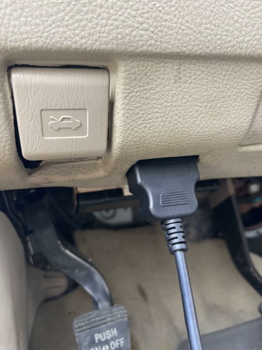

Every car has an OBDII port; it’s usually situated below the car’s steering wheel. Plug the Ancel AD310 cord into your car’s OBDII port. (Note: the car must be turned off before you plug in the scanner – turn it on after the scanner has been plugged properly).
ANCEL AD310 OBD II Car Diagnostic Scanner user guide

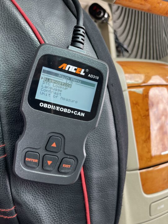

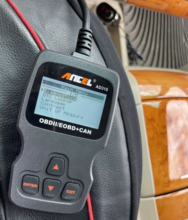

With the ANCEL AD310 connected to your car, turn on the ignition and press any button on the device to continue. Next, you’ll see a menu list indicating the following: Diagnostics, Language, Contrast, and Unit of Measure.

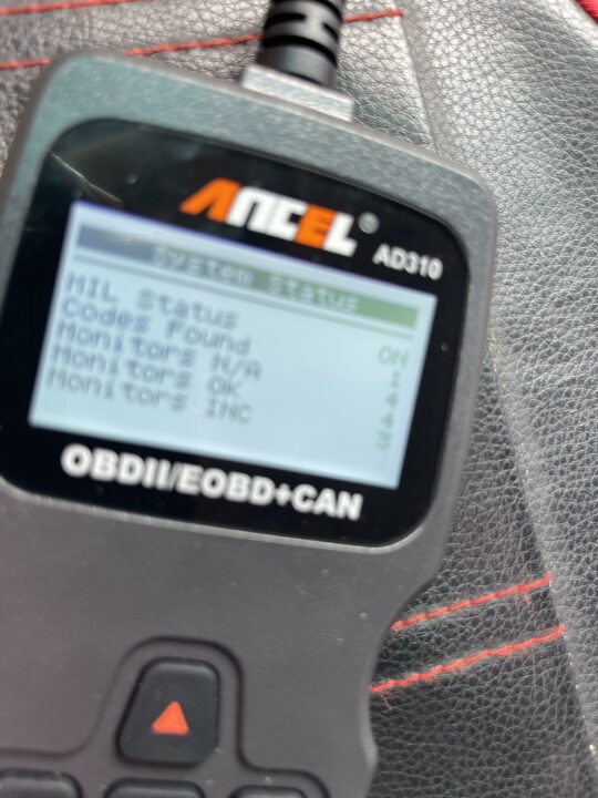

The “Diagnostics” option is to scan your car for possible DTCs. There are many diagnostics options to check out – the System Status menu is where you’ll see the options to Read Codes, Erase Codes, View Freeze Frame, Live Data, Vehicle Info, and run I/M Readiness.
Now, you select the one you want to perform and continue with the prompts shown to know. Literally, operating the AD310 is intuitive, you won’t have a problem understanding where to go from where.
Also, this is a multilingual tool; if you need to use it in a different language (other than English, which is the default), from the first menu, select the “Language” option and pick your preferred one.
The “Unit of Measure” option is there for you to change the unit measurement of the device’s reading. For example, you may want it to read specific data in inches, other than feet/foot. There are other choices there – you can switch at any time.

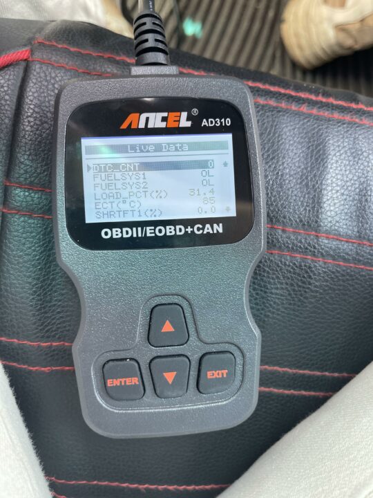

Ancel AD310 Live Data
When you pick on the live data feature of this OBDII scanner, it brings up quite a lot of handy information, which includes the following:
  • DTC_CNT: Diagnostic Trouble Codes Continued
  • FuelSYS1: Fuel System 1
  • FuelSYS2: Fuel System 2
  • ECT (in Fahrenheit): Engine Coolant Temperature
  • LOAD_PCT (%): Load Percentage
  • VSS (mph): Vehicle Speed Sensor
  • SHRTFT1 (%): Short-Term Fuel Trim
  • LONGFT1 (%): Long-Term Fuel Trim
  • RPM (/min): Revolutions Per Minute
  • MAP (inHg): Manifold Absolute Pressure
  • IAT (in Fahrenheit): Intake Air Temperature
  • SPARKADV: Spark Advance
  • TP (%): Throttle Position
  • O2S B1 S12–B2S: Oxygen Sensors, Bank 1 and 2
  • O2 B1 S1 (V): Oxygen Sensor, Bank 1, Sensor 1, V style engine
  • O2 B1 S2 (V): Oxygen Sensors, Bank 1, Sensor 2, V Style Engine
  • SHRTFT B1 S1 (%): Short-Term Fuel Trim Bank 1, Sensor 1

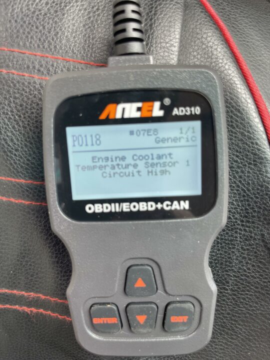

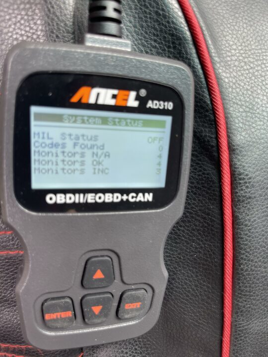

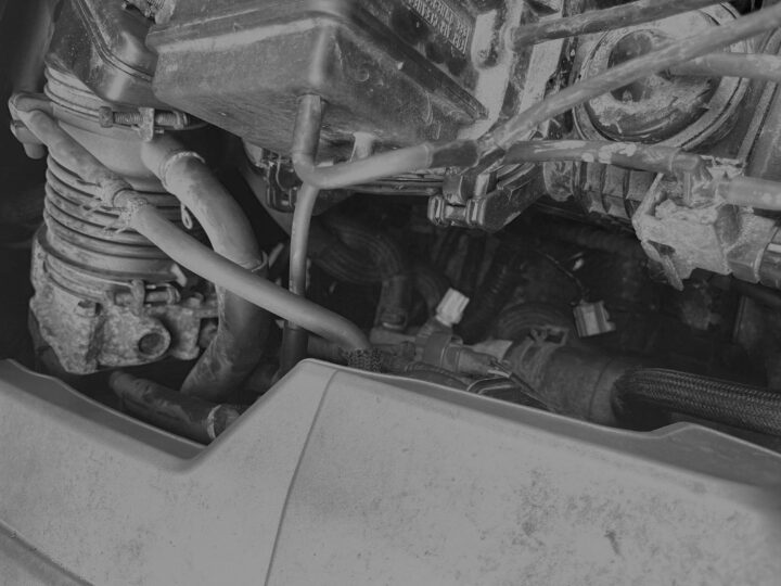

As expected, there were no check engine lights on the Lexus vehicle prior to plugging the OBD2 scanner into it. To see its error-detecting capability, I unplugged the coolant sensor from the engine bay (as seen in the screenshot below).   unplugged coolant sensor
The next three images below show the scan result when the coolant sensor was still intact, when unplugged, and the fault’s description.
no fault detected
The first scan (when the sensor was still intact)
fault detected
The 2nd scan (with the coolant sensor unplugged)
OBD2 fault description
The fault’s description with the P0118 engine code
