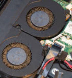

1. Dust Accumulation
Dust Accumulation in laptop fans
One of the most common causes of a noisy fan is the buildup of dust and debris. Dust can clog the fan and vents, reducing airflow and causing the fan to work harder and noisier.

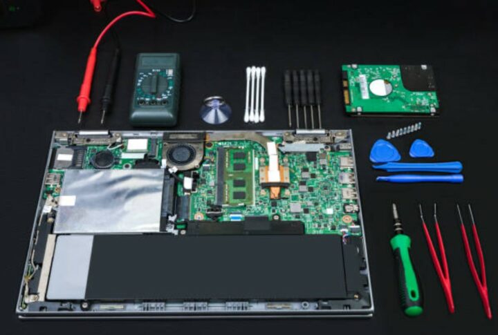

1. Clean the Fan and Vents
Tools Needed:
  • Compressed air canister
  • Small screwdriver (if disassembling the laptop)
  • Soft brush
Steps:
  • Turn off the laptop and unplug it from any power source.
  • Locate the vents on your laptop. Typically, they are on the sides, bottom, or back.
  • Use the compressed air to blow out dust from the vents. Ensure you use short bursts to avoid damaging the fan.
  • Disassemble the laptop (if comfortable doing so) following the manufacturer’s instructions to access the fan directly.
  • Clean the fan blades gently with a soft brush or compressed air to remove any dust buildup.

5. Replace a Faulty Fan
Steps:
  • Diagnose the fan by observing noise patterns and using software diagnostics.
  • Purchase a replacement fan compatible with your laptop model.
  • Disassemble the laptop following the manufacturer’s guide to access the fan.
  • Replace the faulty fan with the new one, ensuring all connections are secure.
