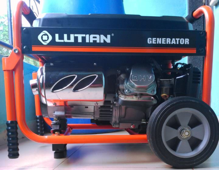

Introducing Lutian LT3900E 3.8kVA Petrol Generator
Lutian gasoline generator review and price in Nigeria
Lutian LT3900E gasoline generator is an R classified (220V 50Hz), 100% copper made, air-cooled, 3.5kVA rated power generating set from Lutian Machinery Co., Ltd.
It features an electronic key starter for simple, quick-starting , a high quality automatic voltage regulator (AVR) for the safe-running of voltage sensitive electronic equipment and an oil alert system that indicates low oil levels by triggering an automatic switch off (of the machine) to protect the engine.
Other intriguing features that’s shipped with this power generating set includes: an easy-to-read display unit that indicates volt/amp meter, running frequency, and an automatic circuit breaker that shuts down the generator in critical situations such as over-load, bad connections, malfunctioning equipment and etc.
Lutian LT3900E 3.8kVA generator also features: a Pilot Lamp function that indicates the proper working of the machine and a Fuel sediment cup that stops dirt and/or water molecules from getting into the carburetor from the fuel tank. There is also the 12V/8.3A D.C output unit that comes in handy for the charging of car and/or inverter batteries.
As usual with most consumer generators, it is equipped with a rope-pull mechanism (Recoil) for starting the power generating set manually. There is two wheels also for balance and quick movement of Lutian LT3900 generator from one point to another.

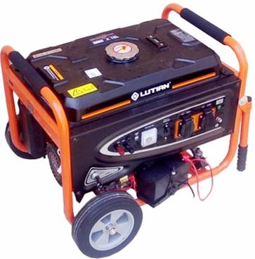

While coupling, the most difficult section we met was fixing the battery unit as there isn’t a credible screw-base unit built for it. We managed to firmly fasten the battery base with a single bolt, nut and washer.

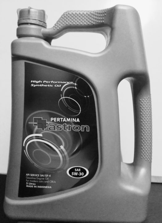

Another basic need was the use of SAE 10W-30 (or 5W-30)  4-stroke premium quality engine oil that’s certified to completely meet or exceed the U.S. automobile manufacturer’s requirements for service classification (SF/CC, SG, CD).
pertamina SAE 5w-30 Synthetic Engine Oil
We found one that’s produced by Pertamina and retails for about ₦12,000 ($35) per 5 liters storage can. Lifted the machine sideways to fill to gauge.
We used the manual rope-pull starter for first use as the battery unit shipped with it was completely down. Our overall first impression was positive as the noise-level wasn’t as loud as our previous machine.

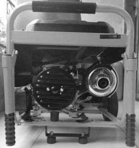

While we are highly impressed with the oil alert system that steadily monitors the oil-level in the generator’s crankcase and automatically shut down the engine if or when the oil-level falls below safe limits, we are somehow disappointed with the positioning of the oil filler, as it makes it hard to refill oil conveniently without a long (or special trunk) funnel.
Another ill-feature of this unit is the air cleaner’s waste hole that stains the floor with excess oil released. A tiny container holder underneath the hole would have done a better job by holding the excess oil until they’re cleaned up with a towel or rag.

The battery base is designed to fit beside the alternator. You will have to completely remove (or cut off) that black stud under the alternator to fit in the battery properly. It was installed to protect the alternator during shipping. Just slide in the base and you will see the matching holes. The bolts and nuts are in the box.
