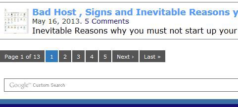

How to Add Numerical Pagination to Mobilepress Default Theme Without Using Wp-PageNavi :
add pagination to mobilepress without wp-pagenavi plugin

Now that’s all, save and enjoy a more intriguing numerical pagination for your mobile site .
