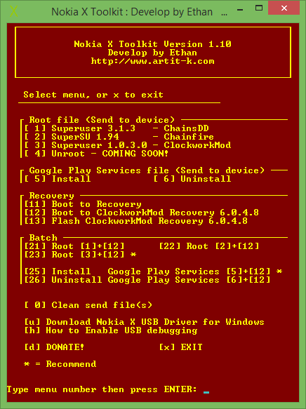

  • Download Nokia X Toolkit from here or here
  • Run the Nokia X Toolkit and notice a screen looking like the one below
Nokia-X-Toolkit tutorials
  • Select the root  Option 21
  • Allow sometime for it to get done with its magic; your phone will be booted into CWM once done.
  • From the Window ==> Navigate to Mounts And Storage ==> Mount System
  • Select Flash Zip from your SD Card and locate the zip of Superuser ==> Flash it and select Reboot after flashing it.
  • Select NO when the CWM fixing prompt shows up
  • Install the root checker app to confirm your device is now rooted.
