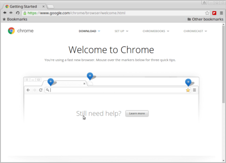

How To Download Chrome For Linux Distros?
Google Chrome for Linux
Here is how to do Chrome install for your PC that’s using any of these two popular Linux Distros. Note: While there are many Linux distros available, I’ll be focusing on RedHat and Debian-based distros.

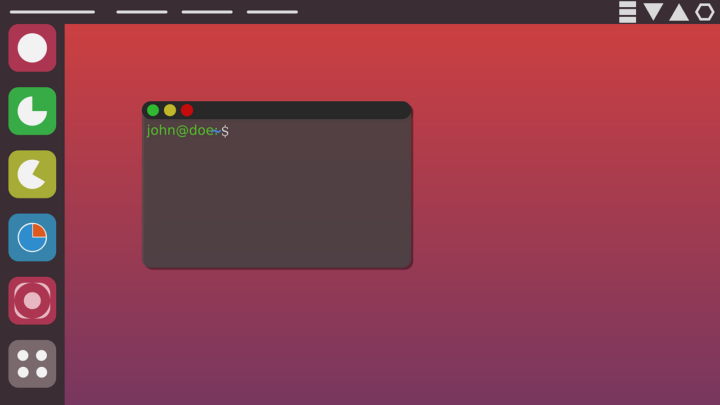

For Debian Linux distros (Ubuntu, Kali, Debian, and Linux Mint), you can get the official stable Google Chrome browser by running the following command in the terminal.
Command: wget https://dl.google.com/linux/direct/google-chrome-stable_current_amd64.deb
After getting the core files from the repo, you then need to run the following command to install it:
$ sudo apt install ./google-chrome-stable_current_amd64.deb
After you have installed Chrome with either of the commands above, you can check the version you installed by running this command: $ cat /etc/apt/sources.list.d/google-chrome.list
Furthermore, just in case you decide to remove the browser from your system in the future, you can do that using:
$ sudo apt purge google-chrome-stable
What More?
After installing the browser on your system, to launch it, use the $ google-chrome & command. Getting Chrome on Linux distros is really not a big deal.
