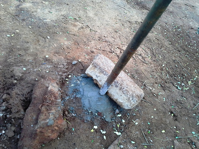

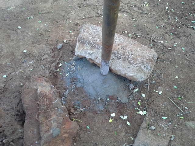

This part is necessary if you are going to use a pipe and not the house roof, wall, or wooden fetcher board before the roof.
The pipe must be fixed on an open space without trees and/or other hindrances. Below is the tools necessary for mounting your satellite dish in an open space outside the building or with a longer pipe.
  • A cup of Cement mixed with stones
  • a trowel
  • Cutlass or shovel (for digging of the hole)
  • A paint of sand and a bucket of water

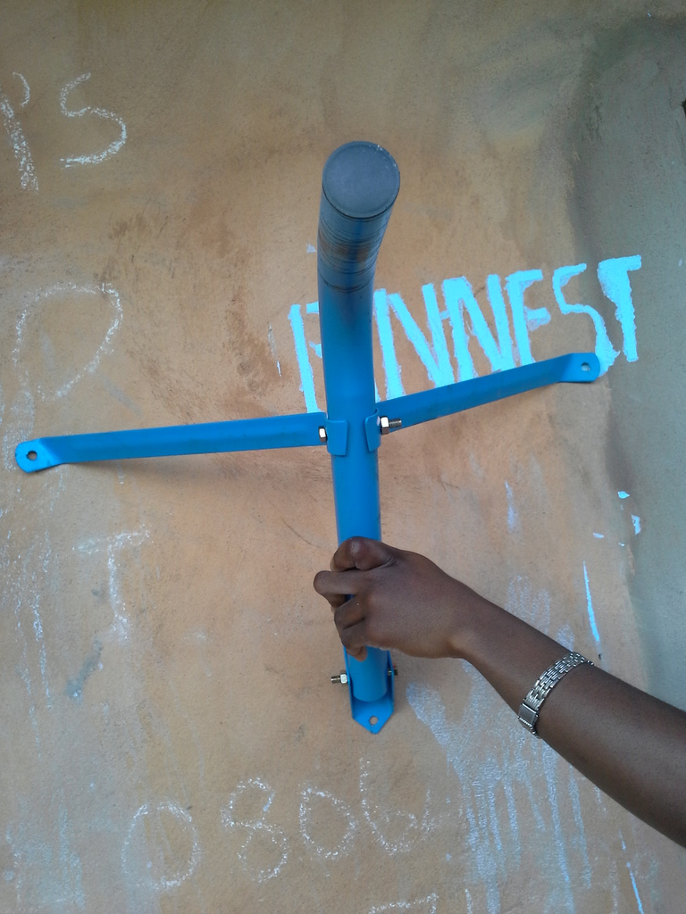

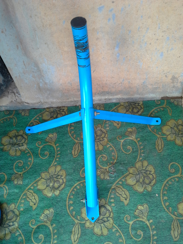

How to Setup the Satellite Dish
The satellite dish components will usually come in separate parts and must be arranged in such a way that makes it easy to receive signals and withstand strong wind.
The arrangement of the dish components depends on where you intend to mount it. If you are going to mount it on a root, wall, or wooden fetcher board of the building, look at the image below for how it should be coupled.
If you intend to mount it on a pipe outside the building, look at the image below and use the tools listed in the extra tools section above to make it solid and well-grounded.
The last thing needed to complete this section is to fit in the screws and nuts in the reflector’s (dish) rear and connect the LNBF accordingly. See the images below for the tips.

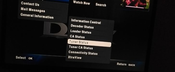

This is an important update for those asking for help on how to properly position their satellite dishes after relocating from their old residence and/or when the dish position gets tampered with by kids playing within the surroundings.
This section would also come in handy for those experiencing very poor reception, distorted audio, and poor visual rendition.
Here, you won’t be needing a digital meter or strong decoder as the built-in signal tuner function that comes with DSTV satellite dish decoders will suffice.
Top 7 Ways to Choose the Right TV Lift
What you need to do is this-
  1. Position your TV in such a way that- it can be viewed clearly while turning the satellite dish. You’ll need to take it outside in most cases or ask someone else to look at the TV and give you updates while you play around with the satellite dish positioning to various angles.
  2. Turn on the entire system and press the Help button on your remote control.
  3. Scroll down to general information and then Tunar Status to your right.
  4. Click the Tuner status and use that to set up your satellite dish for the best delivery. Anything between 60 and 98 is perfect and would be hardly disturbed by rain and/or poor weather.
Here’s a short video to help you locate this menu option with ease.
