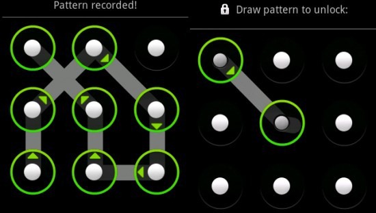

While a few Android users prefer locking their phone with a code, the majority of us use security patterns which could be difficult playing around when forgotten, this is when your Gmail or Google account comes into play.
After being greeted with this awful message “You have incorrectly drawn your unlock pattern 5 times ” or “too many wrong pattern attempts” or worst still you aren’t getting any prompt but know that you have forgotten your pattern and even in most rare cases a pattern security access was set up by your younger ones without your consent.
Here is how to fix them up quickly!
  • tap the “Forgot Pattern” to bring up Google account options.
  • enter your Gmail or Google account details in the provided boxes and hit the “Sign in” button to unlock your phone or tab.
  • Set up a new security lock or pattern that you can easily remember.
