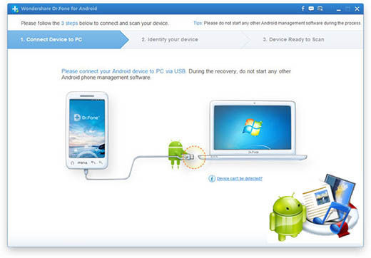

The most effective way to factory reset your Android device without loosing important data is to connect it to a PC with an up_to_date anti-virus program (Kaspersky recommended) and do a comprehensive backup using dedicated Android PC suits such as  Moborobo or Wondershare MobileGo.
Then format the device completely by Navigating to settings ==> backup and reset ==> factory data reset. Reconnect your device once the factory reset is completed and restore the previously backed up data.
Note that the Anti-Virus program on the PC would normally scan the back-up files, so you will need remove and scan your memory card differently before connecting it back to the mobile device.
