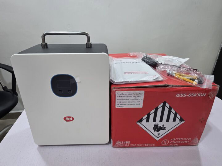

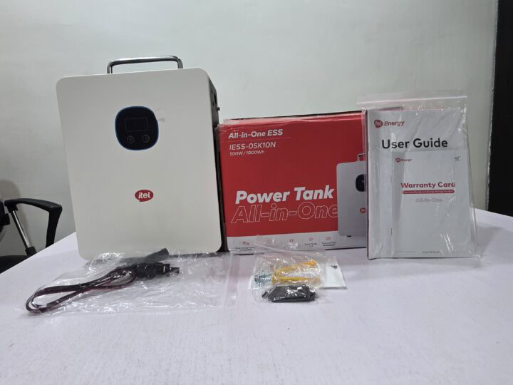

As shown in the short video above, these are what to expect with a new purchase of the iTel 1KWH solar inverter power tank:
  1. The iTel 1000Wh solar generator with 500W power output

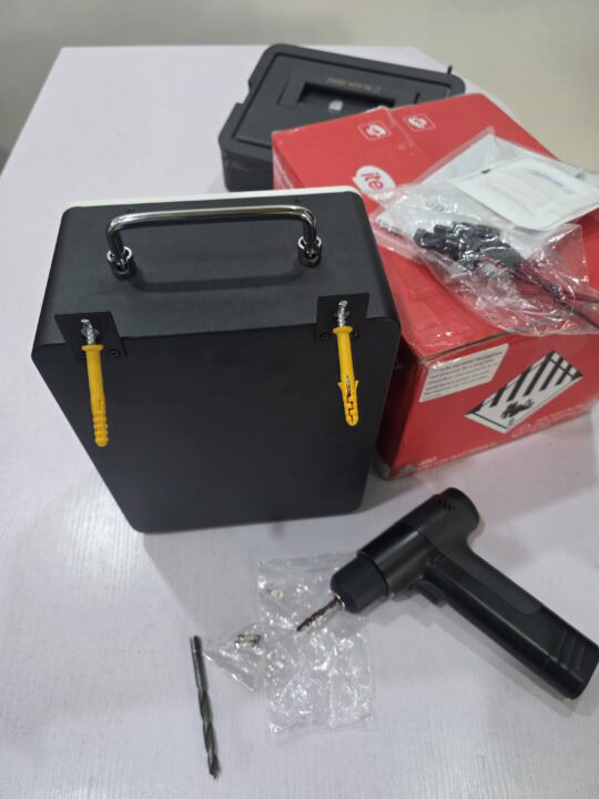

  2. The device-mounting kits (which include: 2 PCS of mounting brackets, 2 PCS of expansion screws, 2 PCS of rawlplug fishers, and 4 PCS of sunk screws, as shown in the image below).
Itel Power Tank Unboxing Review
  1. An RNB2-4L Cable Lock
  2. AC power supply cord for charging the residential energy storage system with the main grid
  3. Photovoltaic DC power cable for connecting the unit to the solar panel
  4. 2 PCS of 10AH 250V Ceramic Tube Fuse
  5. The user manual
  6. The warranty form and qualified certificate

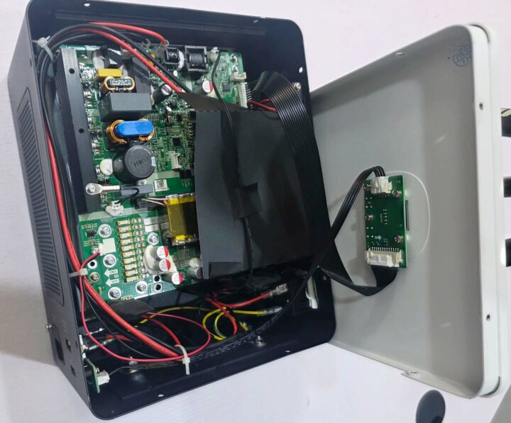

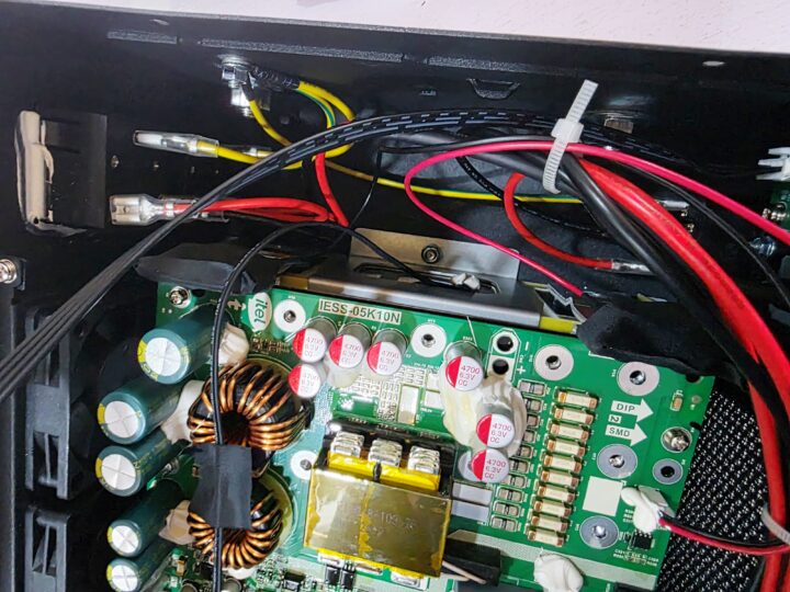

6. Solid Build and Sturdy Casing
the build quality
A picture showing the sturdy build quality of the internal components of the itel 500W power tank
Unlike some itel phones, this power station’s quality was in par with some of the best solar products in our collection. I actually opened up the unit to confirm the battery size, as weight alone shouldn’t be the only thing I should be looking at (please don’t try this on your end – as it’d void the warranty). The quality of the MOSFETs, capacitors, and inductors used was actually great, unlike the MOSFETs on a generic unit I bought some years back that fries like every eke market day🤣.
Overall, the build quality is great, and the internal components are solid with protective adhesives attached to the connecting ribbon ends, capacitors, etc.

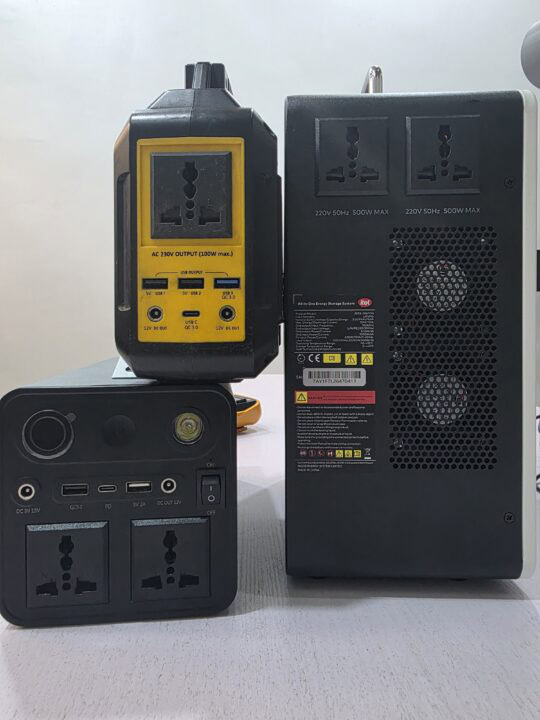

1KWh Itel IESS-05K10N Power Tank Vs. Other Portable Solar Generators in my collection: My Personal Review
itel power tanks vs other products
In the picture from the left: A generic 300W solar generator, a 100W Qasa Solar portable, and then the Itel 500W power tank
As stated earlier, I am not new to portable solar energy storage systems, as the 60W MTN Lumos I bought in 2019 is still playing a small role in the family house now in 2026. To digress a little, I first used MTN Lumos in 2018, bought the Eco variant in 2019, and still went ahead to get the premium variant that comes with 2X 80W panels in 2020. Moving away from Lumos portable power, I have used Lutian 1000W Output solar portable, Qasa solar portable, Sunking solar generator, and generic solar power stations.
So, over the years, I have used different types of solar solutions, including “all-in-ones” and full solar inverter solutions. Today’s review will focus mainly on these three that are right here with me. I started the test with a 250W solar pressing iron, Magcubic Android projector, and a few other gadgets, and then ended it with a 600W hand blower. The full performance will be published on our YouTube channel a few days from now.
To sum up the results, they all perform well within their power ratings. The burst power in the iTel power tank was also impressive, as it properly powered the hand blower that’s rated above 500W without draining the battery.

To mount it on the wall by yourself, you can follow the guide in the user manual or simply copy what I have done in this attached photo as a quick pointer.

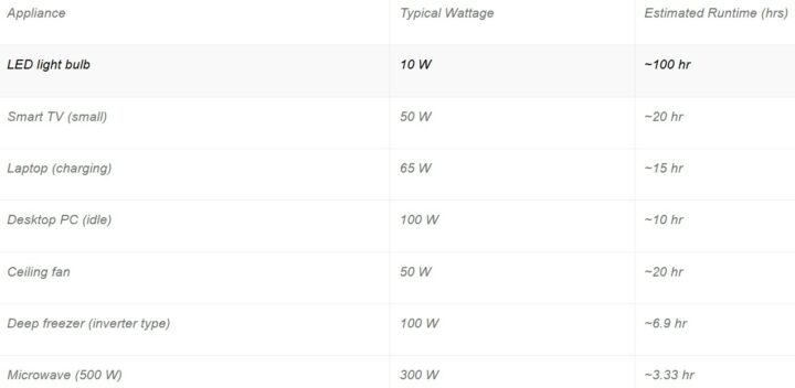

As mentioned earlier, this is a portable power generator for powering small accessories and devices at home. It can power any electrical device or appliance with a power of less than 500W, which includes TVs, home theatre systems, laptops, phones, IoT devices, Starlink router, and other small devices. But if you’re going to connect multiple devices and appliances to this solar generator, make sure they don’t collectively exceed a 500-watt power draw.
While some refrigerators, freezers, and inverter ACs may be rated below 500W, it is not advisable to run them on this power tank. So, when using the iTel 1000Wh portable generator, you have to be calculative; it gives you control over what to turn on and what not to turn on at a time.
This device can be used while it’s charging, but that can make it charge slowly (depending on the connected load). While it isn’t built for refrigerators, I tested one inverter fridge on it, and it worked perfectly well. You can comfortably power the standing fan and lighting points in your self-contained and one-bedroom flat apartment with this solar generator.
